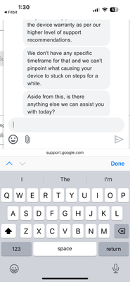

Similar for me. Updated a few days ago and while it still works it definitely is not tracking my steps correctly. Stays frozen on steps for a while and eventually starts to track again

I did a chat for support again today since it’s been since April without any improvement. Doesn’t seem like they are trying to repair this issue. I have been a faithful Fitbit user for years but may look at alternatives if they aren’t supporting the products to work properly after customers trying to be patient.
