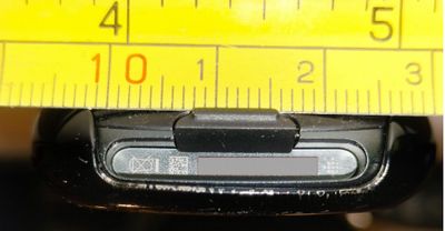

01-16-2024 22:22 - edited 01-16-2024 22:24
The opening of the Sense 2 is pretty much 24mm, including the rounded ends. Here is image:
01-18-2024 21:50
01-18-2024 21:50
Thank you. It would appear I've the wrong watch then. bought in Greece and its definitely the top strap. At least I know what to order now!
