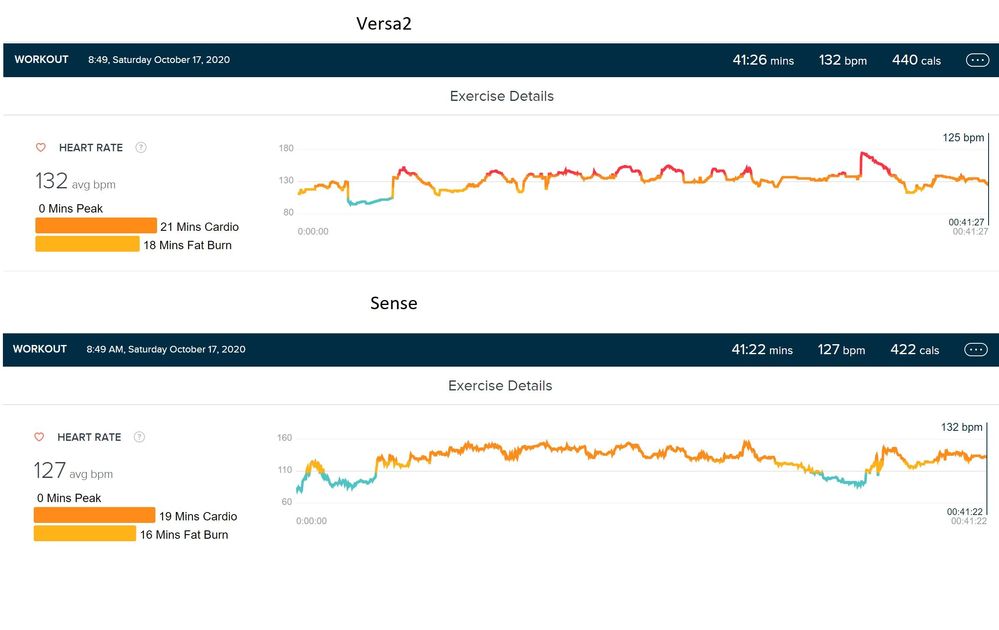

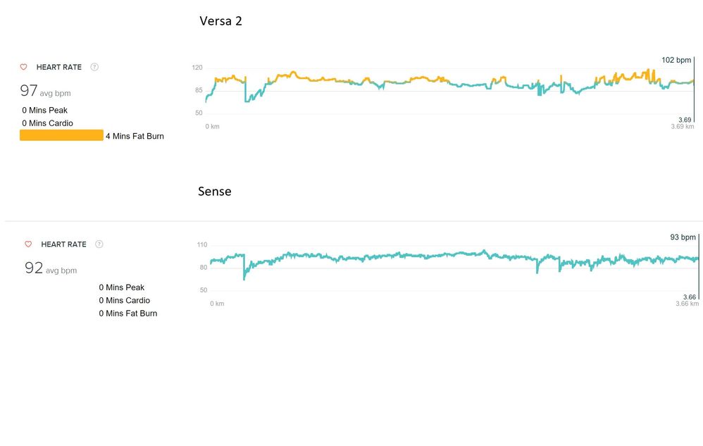

I'm a Versa 2 user and have been using the Sense for roughly two weeks now. I've done lots of workouts, walks, bike rides and hikes with both watches on and wanted to share some of my findings.
I don't want to say that something is wrong with the new heart rate sensor but it definitely is calibrated differently than previous versions. Since Fitbit has chosen to stay silent on this matter leaving us in the dark whether they consider this an issue that they should fix, I'll be returning my Sense for now. Hopefully this can be adjusted with future Firmware updates and I'll be watching the forums here. Apart from the HR Issue I really like the Sense, new Fitbit OS is better and the additional sensors have potential.
Here's a few workouts comparing the Versa 2 and the Sense:
Workout
Hike
Workout
Walk
