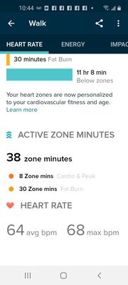

How could I get 38 zone minutes with a max HR of 68? In 11 hours. I must tell my ♡ doc it isn't helpful. I hope the arrhythemia study Fitbit is doing illuminates some of our issues...

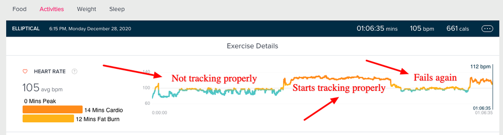

I found this thread via a Google search & I'm glad to know that I'm not the only one.
It seems to do fine when I'm not active, but falls all apart when I am.
From today:
There's just no way that my HR was higher during a my ten minute Yin yoga cool down than when I was crushing myself on the elliptical.
(The elliptical's hand sensors - which I admittedly don't usually consider terribly accurate - consistently had my HR at between 145 and 160 and that seemed much more on point than what my new $200+ smart watch was saying.)
I'm pretty annoyed.
I do about more searching before returning this, though - if it's a software issue, I'm willing to stick it out for a bit, but if the hardware's shot then I can just say that I'm glad that I got my Sense at Costco.
