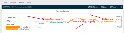

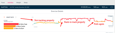

03-05-2021 10:22
The heart rate fails during the workout. View the above images to see how it fails.

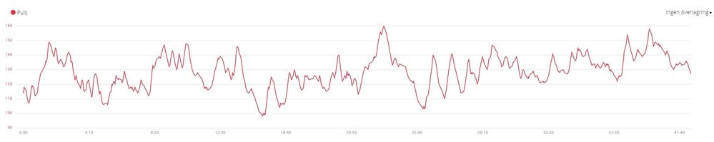

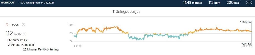

Same problem here. Same workout, starting with spinning the first 12 minutes, then doing gym exercises, you can compare the Fitbit Sense to another product I bought a few weeks ago and was using in parallel.
When I'm starting with gym exercises the Sense drops to 70-80 bpm and stays there for a long time.
The other product never falls in bpm under 100.
After the 41 minutes training the average BPM is:
Fitbit Sense = 112
Other product = 128
