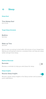

You mean like target sleep hours?
Best Answer12-30-2020 23:18
12-30-2020 23:18
Best Answer12-31-2020 00:25
12-31-2020 00:25
Okay, they’ve been removed since I replied last, but nothing yet.. I have slept since then, but I’ll update in 5-6 hrs if it’s changed anything. I did do a reset as well after.
