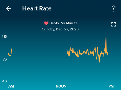

12-27-2020 19:56
12-27-2020 19:56
@sarcazm when on charger my sense shows HR on display but nothing is actually captured. See image below. When belly up the sensor is off.
