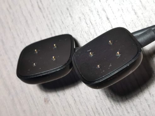

Hi Community, has anyone experienced an issue with the charging cable pins recessing into their holes? I was given a Sense as a gift a couple of months ago and noticed the other day that it had stopped charging. When I inspected the cable, I can see that one of the pins has crawled back into the hole.
Is there any way to perform a DIY fix? I have seen cables on the market that you can purchase, but I don't want to go down that route yet as the watch is pretty new. Any suggestions would be appreciated.

The aftermarket charger I suggested in earlier posts has now done the same thing with one of the pins. The design is slightly different to the original Fitbit charger, so I wonder if the way it snaps onto the back of the watch with the magnet has something to do with it? I purchased it in February, so it has given me approximately 6 months use.
I'm confident all of us would have been very reasonable with how we use the charger. I'm not sure I could be bothered having to constantly pay for a replacement, there are plenty of other smart watches on the market that do similar things.

I’m having the same problem. It’s so frustrating that there’s no way to pry the stuck pin back out. I just recently changed from the versa which didn’t have the pin chargers. I’m not sure why they changed chargers if this is a common problem

Thanks for the tip about the tin foil! It worked! My charging cable pin just broke and my watch is at 10%. I purchased my watch almost a year ago so I don't think I would have much luck getting a replacement cable from Fitbit. Replacement cables from Amazon are on the way!
I just had the same issue. Seems as thought the springs that push the pins back up break without any warning. Contacting support.

I got a Sense last Boxing Day and in February it stopped working, so they sent me a new one.   About a week ago it would only Slow Charge if I was lucky.   I read a post in here about the pins and I checked mine and sure enough only 3 were visible.  I sent a picture to Fitbit Support and about 5 days later Purolator delivered a new charger.  Just contact them and give them a picture of the pins, it was all done by email, easy peasy.
