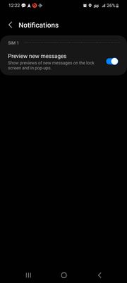

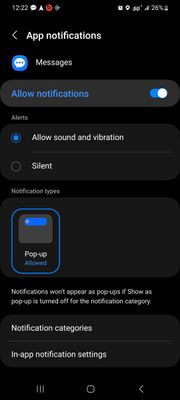

GUYS!!! I found the answer !!!!(for android anyways) if you go to your messages settings , then app notifications,scroll down to notification categories, and swipe over and turn on the "preview new messages " and YOURE DONE !!!hope this helps !!!! Sorry apple...
