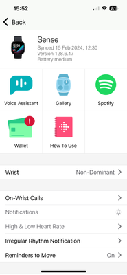

I opened the App and hit the icon as you suggested. It opened another page - see attached
01-31-2025 05:04
01-31-2025 05:04
@Phbsense That page information is the sync information from the last sync in Feb 2024. If you can't start your Sense by pressing an holding just the haptic button on the left, then I think your battery is dead.
