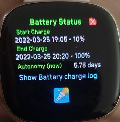

@Teak24- some of the features are there by default, even if you don't see them, further checking may turn up the cause as it is common to miss them and only get 2 days per charge.
I have mine turned off / removed and get at least 5 days per charge.
Example days days betweeb charges

How do you find the stats in your photo? Ie. The charge start/stop and autonomy?

The image is from the SimpleClockPro watch face I use, to demonstrate the possible battery life..
