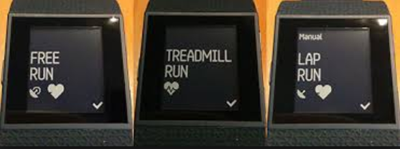

@Shaw54 Exactly! Your update is correct, as you can see in this picture the option Treadmill doesn't have the option to connect with the satellite; since this activity doesn't need to be tracked using GPS. So, you're right! Keep using Treadmill run for indoor activities and Free Run for your outdoor runs. That should work for you! Woman Very Happy

It is weird. The running data transfers whenever I'm outdoors using the GPS. However, when I run on an indoor track, using the "Free Run" option, the watch tracks the run stats (I can check the time/distance/avg heart rate) but the data does not transfer to the Dashboard. Maybe I should be using the "Treadmill" option for indoor running?
An update. I tried the "Treadmill" setting and the data transferred successfully. So it appears the "Free Run" setting does not work indoors.
