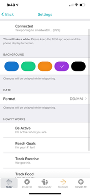

this was the issue I had. Then unlinked Fitbit from snapchat and can’t get it to connect again. And now it says 99% but the bitmoji is completely gone.

@AJNSD Welcome back to the Community. Thanks for the screenshot attached.
I've shared your post with our Support team and they mentioned that you were in contact with them. Please let me know if you're still experiencing difficulties with Bitmoji and Fitbit and I'll be happy to continue assisting you.
