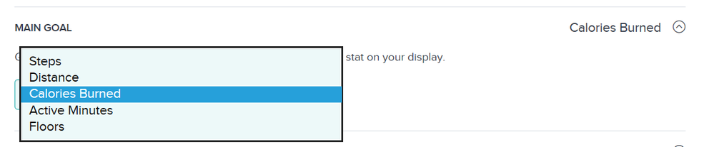

the goal setting is on the tracker not personal profile and says you must have a Goal and you will get a notification.
There doesn't seem to be any way to turn this off, and I can't see how fitbit decides when to send you the notification. Since I have had this wake up call only the one night I have a suspicion the MFP background sync might have triggered the goal? I have thought about choosing a different goal but can't see why those would not be met just as easily and hence inappropriately notified.
