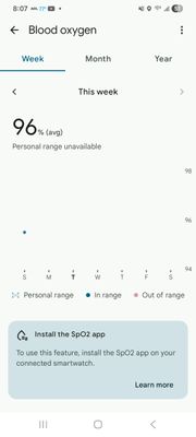

Since last update, Sp02 has stopped working. When i check my daily readings it says I need to install the app.  When I go into settings, it says the app is already installed. I have restarted, uninstalled and reinstalled and it still reads the same. What can I do to correct?

I usually get a reading but it still says I need to install the app and that it's not compatible with my device. Once every few days I get no reading. I am unable to see any O2 reading on my device because there is no spo2 app on my Versa 4. Apparently Firbit can't get it together.

I'm still having the same issue. Worked for 1 night, updated firmware and nothing since. It states the app is installed when looking in my apps, says it's not available or compatible with my device when I click more info under why is not reading it.

Im having the same problem too. Says to install app for SpO2 but the app isnt compatible 🤷
They told me, if I'm running Android to not have my phone attached. On the screen that shows the Versa 4 connected and syncing if you have your phone also able to sync to disconnect it. This was only if I was running on Android, not on apple. I disconnected the phone and it has worked fine since. Knock on wood that is.
I'm confused. Do you mean disconnect my phone from my watch? I must not understand since they have to sync to use the app.
No from the app. I'll attach a screenshot. If it shows your phone connected disconnect it.
However,  it's not worked again. Hoping it's only bc of where my watch was on my wrist. I'm going to see how it does tonight.

I spoke too soon. My SpO2 isn't working again. 3rd day in a row. This is ridiculous. I've tried everything once again. We need a resolution!!
