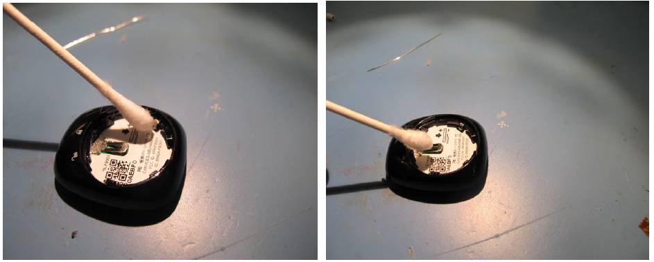

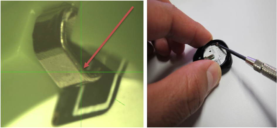

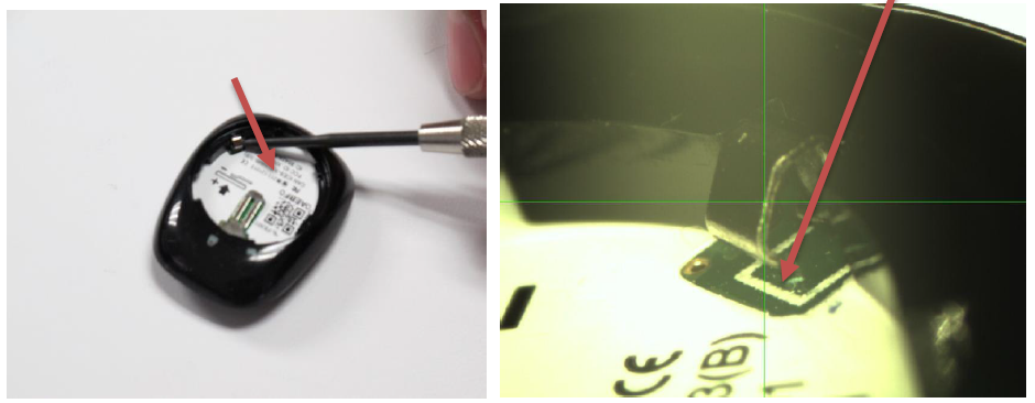

@SnnysAngl I hope you're doing well! Like @SunsetRunner said a weak battery could cause these issues but also make sure the battery it tight within the tracker by pulling the towards you so it secures the battery inside. Also clean the contacts with a cotton swab and rubbing alcohol before adjusting the tabs (refer to the pictures to secure the tabs).
Let me know how it goes!
