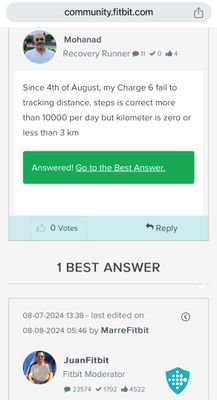

Since 4th of August, my Charge 6 fail to tracking distance, steps is correct more than 10000 per day but kilometer is zero or less than 3 km
