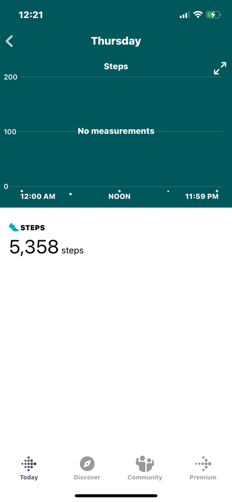

Since the latest ios update, the bar charts showing quarterly hour totals for steps etc are not showing- they just show "no measurements "

Everything appears to be working properly *except* for the fact that the 15-minute interval data is not showing up. It simply says "No measurements". I can tell the aggregate data is working as calories/steps/etc. move quickly when I move quickly, but go more slowly when I stand or sit.unnamed.png

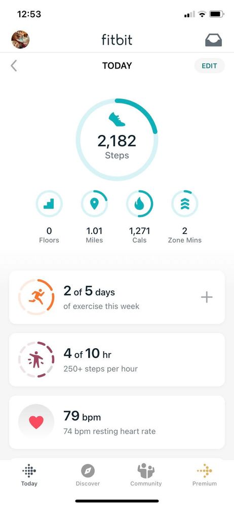

Here is my home screen from just now. I feel that is what I always see when I glance at the app. Thanks!

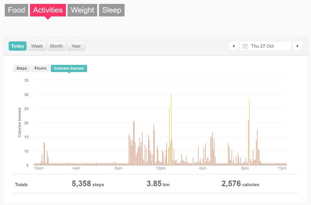

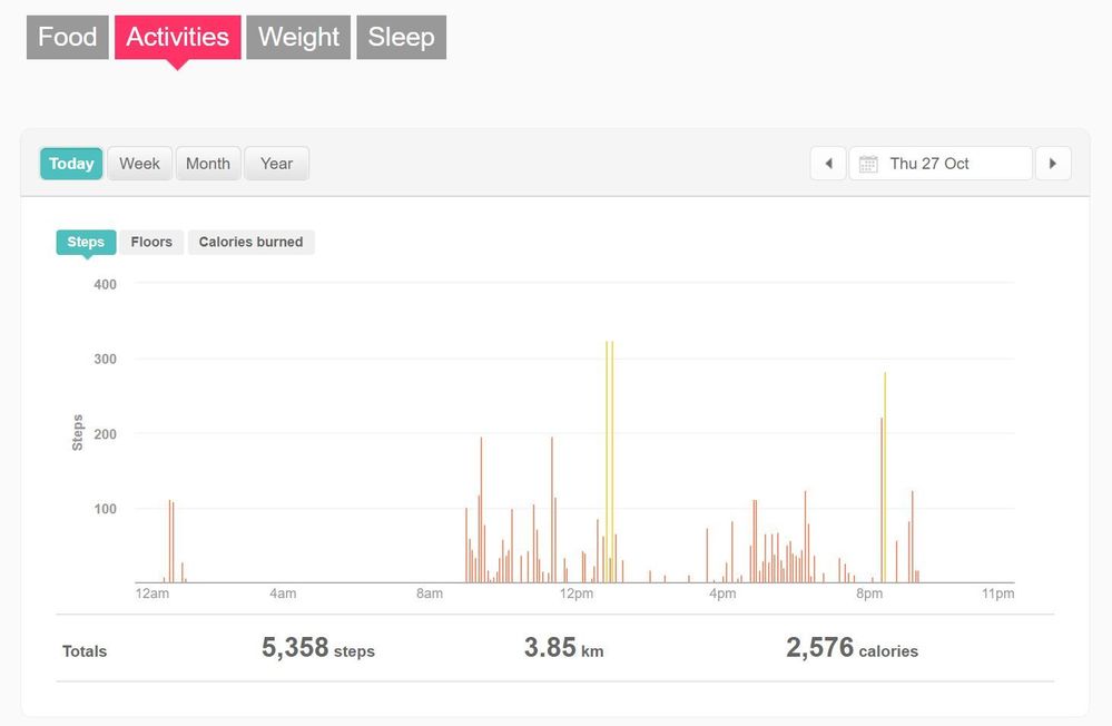

One thing I am curious about is whether the web dashboard is showing the details. Would you be able to log into the Fitbit website and check the dashboard?
No idea as yet why you are seeing this. For the moment if it was me I would not try changing anything until understanding better why the app is not updating.
Interesting call - it is indeed showing the 15 minute granularity that I am used to seeing on the app.
Brilliant!
So now we know that the watch is working fine, the app is updating the website, but for some reason in your case the app is not updating itself. Sounds like a bug report should be filed by the moderators. I suggest calling/chatting with Fitbit support and pointing them to this thread as proof of the problem.

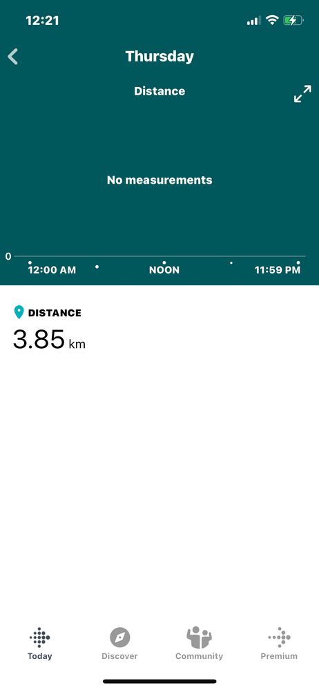

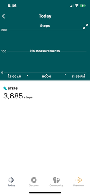

Hi, today is my first time to use Charge 5. Why there are no measurement on both steps and distance pages?

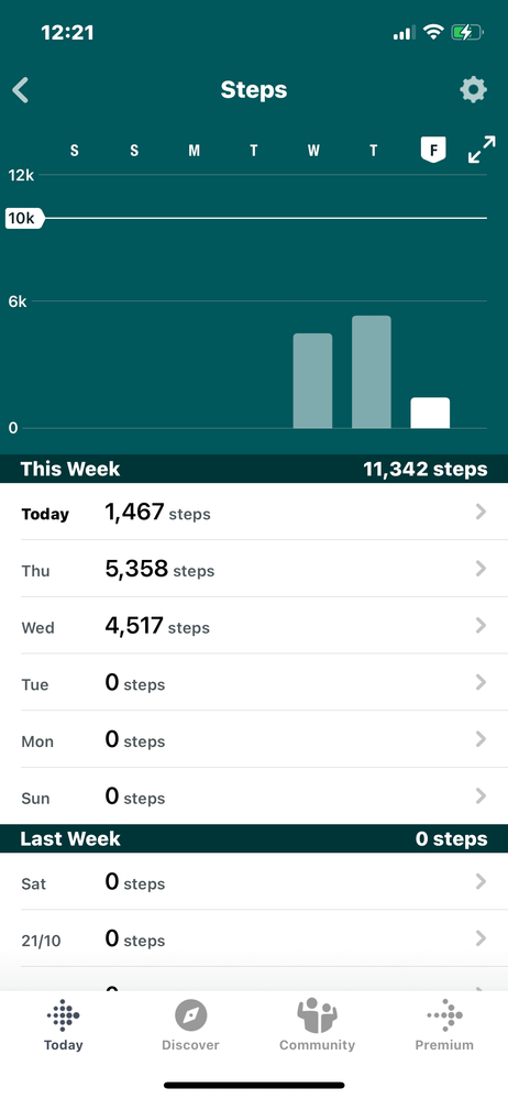

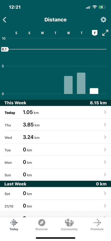

Just repeated my issue here to see if others came across this. I just started to use my new Charge5 3 days ago. I've got my Steps, Distance and Calories Burned data in total per day on the APP but when I dive into daily pages, I can't see any data on the graphic only with "no measurements" on it but I can check them through the Fitbit website. I'm using iPhone 12 and I've updated to the latest IOS system. I also tried to delete the APP and reinstall it, reconnect and synchronize my charge5, and restart my charge5 but still can't get the daily graphic data on the APP. Cheers!
This seems to be a problem with the Fitbit App on your iPhone. Have you tried restarting your iPhone as well?
