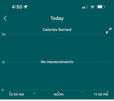

My relatively new Versa 2 is not tracking anything beyond high level data. Every category just says “no measurements” once you click on the daily totals of each category. Where you should see peaks and valleys is just a statement called “no measurements.” Any thoughts? Thanks in advance!

You were part of a large ever-growing group of frustrated Fitbit users. This appears to have happened with the application update 3.69 and was not a fixed and update 3.70 and 3.7 0.1. Fitbit is aware of the problem and states that software developers are working on fixing the issue. It affects distance, steps, floors and calories. Fitbit rolls out updates overtime and overtime the number of frustrated users has grown. We will have to wait for Fitbit to wish you an update with the correction or hope that it be can be corrected without a update. This is probably the best answer you will receive about this issue.

It is well documented in the long thread of this forum: the issue was introduced at the level of FitBit app upgrade 3.69 and is unrelated to your device type or to your IOS version. The data is fortunately not lost (as it can be visualised in the full online website) however it is not possible to see it anymore at the level of the FitBit app despite the fact that it is the mainstream use.
FitBit has acknowledged the issue and engineers are working on it but it is apparently not considered as a "priority 1" issue as it is not yet resolved three weeks later. Normally, more "tickets" (contact fitbit helpdesk) or negative comments on the App Store allow ticket priority to be raised: don't hesitate to signal it on your side.
Helpdesk has imho done its job to report the issue, however the engineering department has not yet managed to prepare a fix or roll-back to former version. Puzzling.
