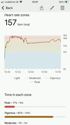

Thanks Laurie, appreciate the response. Interestingly I’ve just had a run and the heart rate is showing on the exercise screen:

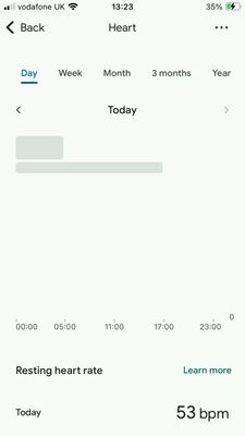

but still no sign from the homepage:
i’ll see how things look tomorrow and maybe step through the reset process afresh.
Thanks again
Matt
