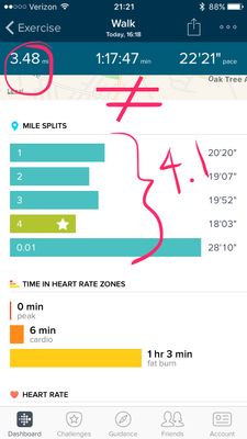

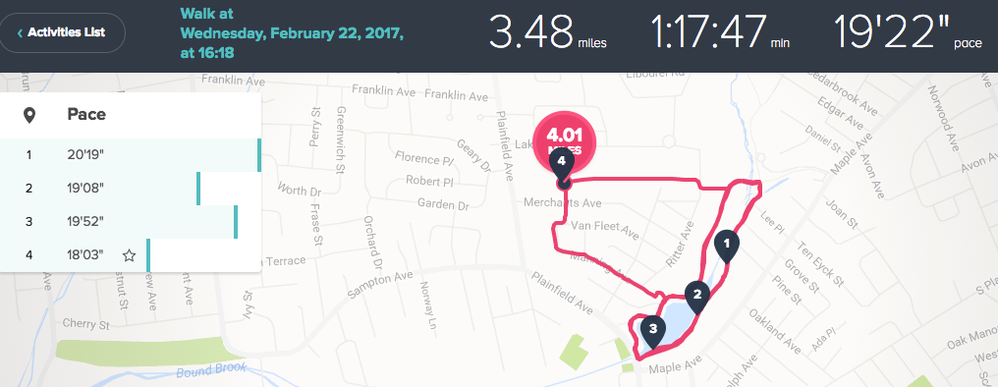

I've been using the iOS app for well over a year and have never had this happen to me...  I walked 4 miles, a known route, watched the FITBIT app roll over to 4 miles ( got the voice prompt, too), yet the log only shows 3.48 miles traveled.  Even the map shows 4 miles...  The units and country are set properly, too.
IMG_3938.PNGmap shows 4.01 miles, log shows 3.48 milesmap shows 4.01 miles, log shows 3.48 miles
UPDATE 03/01/17:
To rule out bluetooth "competition," I used wired headphones during my latest workout (thus the Fitbit being the only bluetooth connected device), and the log was STILL off from the actual total and splits (actual: 3.38 miles /  Fitbit log: 3.32 miles). Smiley Frustrated

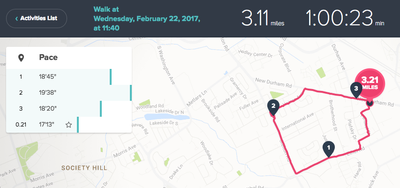

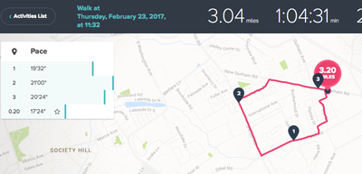

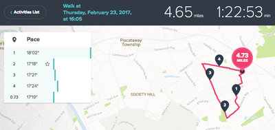

Incidentally I went back to my last few "tracked" activities (those where I use the Fitbit App to track my walks) and noticed the discrepancies started on Wednesday, February 22:
The first occurrence..The first occurrence..Inconsistent, but it's still happening...Inconsistent, but it's still happening...and again later that same day...and again later that same day...
There does not appear to be any consistency to the discrepancies, either...
