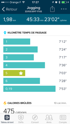

Hello
First sorry but I am French ...
The problem happens when I "follow" physical exercise
When I run there is no problem (time, distance, rythm ...) But as soon as I save the exercise, the datas are changed and get wrong.
Oops ! 200 m for 41:44 min, I must be something like a snail ?
