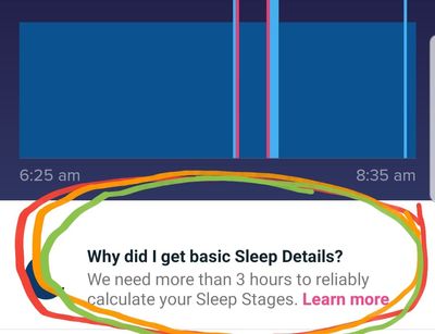

For sleep stages, sleep has to be a minimum 3 hours and have a consistent heart rate.
Is heart rate turned on?
Now open one or more affected sleeps
In the first page look below the simplified sleep chart. If you are lucky you should see the reason for simple sleep

Let's stop guessing, open the Fitbit app.
Tap on a sleep in question.
Look below the graph of simple sleep.

Read that already of course!! And I know that the tracking of my heartbeat seems not constant since over 2 weeks. (mostly at night but also during day time sometimes). But I said, nothing has changed in my wearing, sleeping whatsoever behaviour. I guess this thing is just breaking 😞

If the message says something about heart rate, then there is a problem with heart rate.
