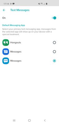

I have a Google Pixel 2 with Android 10 with a Versa 2 and notifications are working ok for text messages.
Just in case, if you have multiple text messaging apps, make sure that the the phone default one is the same as the one you set in the Fitbit app in Settings -> Notifications -> Text Messages.
Mine is set up right. It stopped working after the up grade and I dont wanna switch to the old google messaging. Thank you
Sent from Yahoo Mail on Android
Yeah, I am not expecting you to change your default text app, just wanted to make sure that your default text app is set up in Fitbit. I have a friend that had the same problem, and he solved it by putting Samsung messaging app in the Fitbit Notification Settings. He also did uninstall the app and reinstall it.
