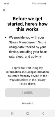

Hi @YNA ,
the Accept response stay's grey if you don't scroll down..... So first read and/or scroll down the terms and conditions, then you can accept and the feature will work.

Exactly @Corr, I also pointed this out above. As you say, it is hard to agree to something that has not been read.

No problems then suddenly aame issue started 2 days ago. Can't scroll down beyond the "I disagree" option. It appears that the "I agree" has been checked. Have uninstalled and reinstalled the tile to no avail
@Dumky3 Hi there. Thanks for the troubleshooting performed prior to posting.
I appreciate the screenshot shared. May I know if you're able to scroll down in the part where it says "We provide you with your Stress Management score" once all that information has been read, you should be able to choose I agree or I disagree.
Hope this helps.

Hi.
Thanks for getting back to me.
Managed to scroll eventually. The secret was to touch the middle of the
text rather than the bottom. Never experienced that before.
Regards,
David
