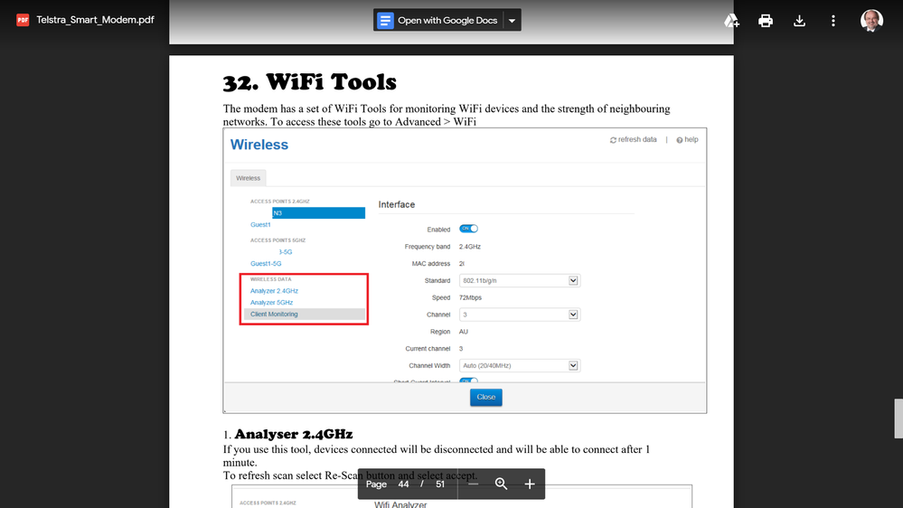

Also having the same issue with Aria scale and Telstra NBN "smart" Technicolour modem DJA0231 - several hours trying to connect (let alone sync) and epic fail. Has anyone solved this?
Best Answer03-22-2020 07:48
03-22-2020 07:48
Someone has put together a user manual for this device. It can be found at:
https://drive.google.com/file/d/1-RqguwOPm8f8gkbX0TsJrt8hqcAXb9E9/view From what I can see under Advanced>WiFi there is a page called WiFi tools. From there you can check to make sure that you have a 2.4 GHz network using 802.11b that is necessary for an Aria to connect. These are beside Frequency Band and Standard. Hope this helps.
