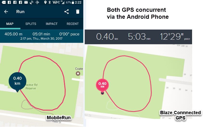

Yes, there are distance issues that many of us are trying to work out. On that simple 400m lap the initial maps showed the same 400m and then after syncing the 2nd map shows 470m.

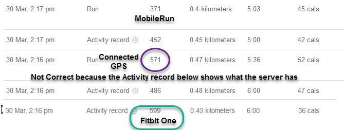

Also there was some juggling on the server because it had synced two concurrent Exercises at about the same time. as you can see from this Activity Log. I added the Activity Records to attempt to see what the real outcome was and that is affected by the lack of a seconds field in the input area.
What I did was something that any computer programmer could not plan for unless they attempted to allow for a multi function device.  This is only a small sample and the 486 steps are correct so when I do my triangular, measured course I will use MapMyRun

To eliminate any Fitbit server shenanigans you should have each on a separate Fitbit account
@bbarrera I will use MobileRun independently next test and then the Blaze on the second test.
I have an account for each Fitbit.
Colin:Victoria, Australia
