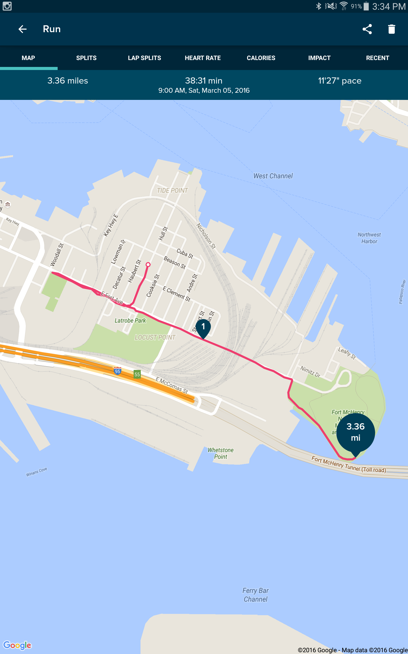

@vdangit wrote:
I just received my Blaze and used it on a run for the first time this morning. It was great except I noticed that afterwards, my GPS map stopped about halfway through my run. It still showed my total miles, pace, and everything when I ended the run. Would this be more of a phone/GPS issue? I have a Samsung Galaxy S4. I only ask because I've had issues with the GPS signal going out before but it usually comes back at some point.

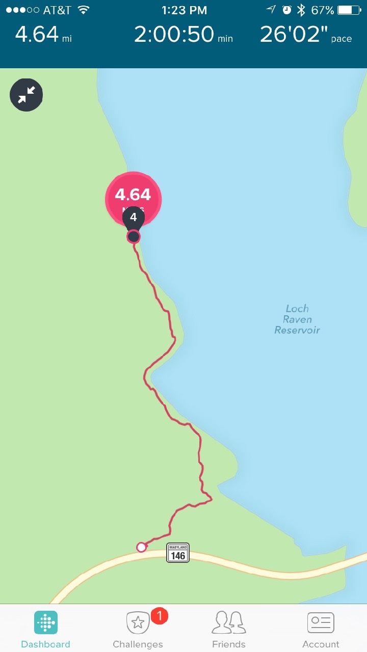

@vdangit - I had similar issue on my hike today. Only got map detail for part of it. I got miles and pace for the whole two hours, but I suspect that it got disconnected temporarily from the phone or I lost GPS when the mapping stopped and then calculated the rest of the distance and pace based on step count x stride length. I've got an iPhone 6 and connected GPS has been working reliably with it until the hike today.
Scott | Baltimore MD

Here's what I get when trying to view my running map afterwards. The map should have stopped after I looped around the fort and went back to the farthest point to the left. Notice that the mile markers for mile 2 and 3 are missing too!

@vdangit -- Ah, Ft. McHenry. Nice run.
Yes, very similar to what happened when I apparently lost connection yesterday on my hike. GPS record didn't even make a mile (no 1 mile marker), so the rest of the exercise distance must have been calculated by steps and stride length.
But my walk this morning recorded correctly.
Hope yours is working better today.
