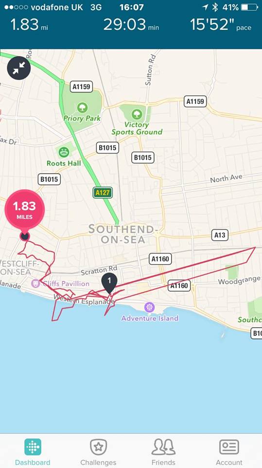

iv just got the blaze and i have an iPhone 6 i connected the gps and went out to day but when i got back and see the map it’s not really what i expected 😞 i don’t remember going in to the sea.
is there away of getting a more accrete gps mapping
That trace looks like your iPhone didn't have accurate gps lock

IMHO it appears that Fitbit doesn't cleanup the GPS data, or doesn't do it well. We've seen forum posts from folks simultaneously recording on Blaze and phone app, and the Fitbit GPS track isn't as accurate, even though its the same gps data.
Phone GPS has gotten quite good, however obstructions, changing satellite constellation overhead, and other variables will lead to some bad GPS data. The better and more mature apps will cleanup the GPS data, and in the process create a more accurate track.
