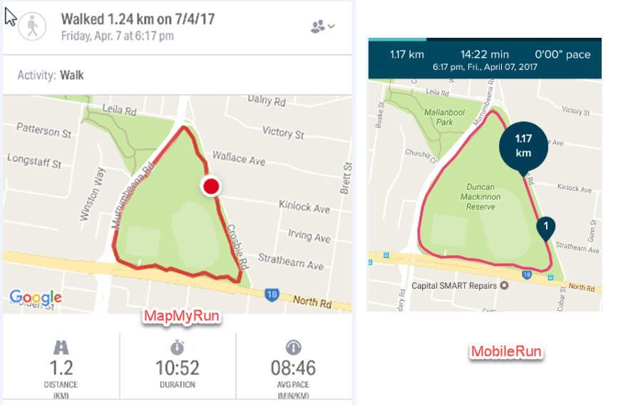

After another user used concurrent MobileRun and MapMyRun I have just completed that same method and here are the results on my measured course. No visible dropouts and the pace cannot compare. But concurrency worked and distance varies again.
@Colinm39 wrote:@mvan231Here are the tests for tonight. I didn't attempt the Polar Beat because the wind was blowing a gale and it would have affected my readings because of the flapping t-shirt on my chest strap H7.
The final image shows the comparison of steps and the Surge GPS with auto stride came very close to the Fitbit One. The word "manual" means... just let the tracker detect the movement.
Also MobileRun did not sync across and no record so that has a Manual record, The mapping was from a screen capture.
@mvan231 I will go out shortly and try a concurrent with Blaze Connected etc and see what that achieves. I will use the Surge as well.
