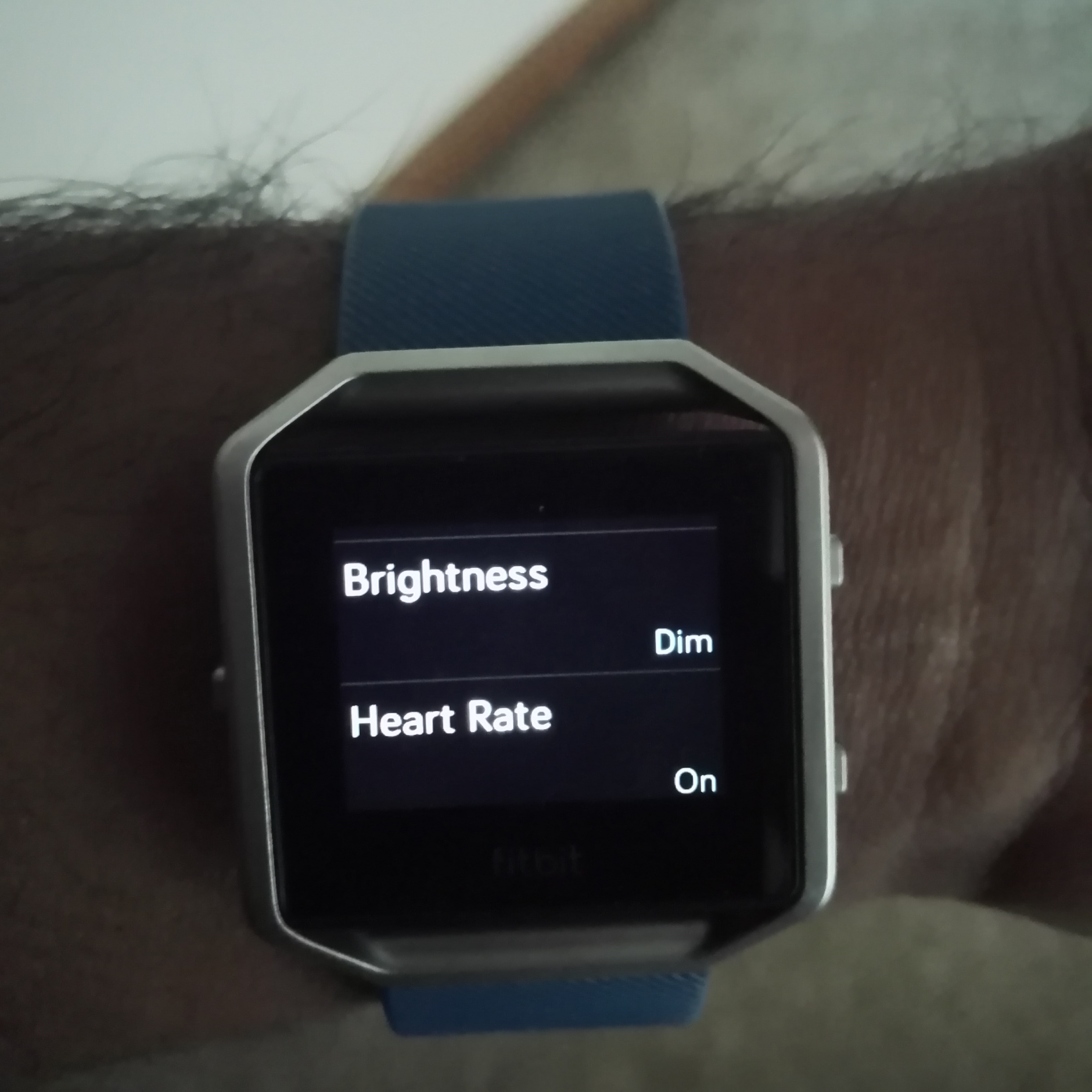

I have the same issue. Sometimes Bluetooth is listed in settings and sometimes it's not.
