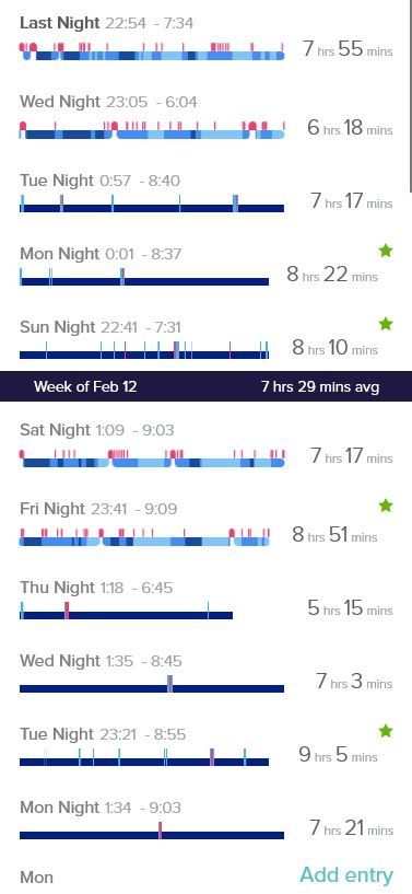

I've had this for a week now, pretty sick of it. Multiple resets haven't helped, I even had my Charge 2 replaced! The new one tracks as poorly as the old one. Tightening my strap makes it worse, moving it on my arm makes it worse. On and on and on... A new solution, please?
I've even messaged fitbit, no response as yet. Is there a lower threshold for the heart-rate detection? I've noticed it's registering my heart-rate as lower lately and I really hope that isn't the problem.

Same problem here....since Feb 15, I´ve tried like you with multiple resets, nothing....even reinstalled the win10 fitbit app...

Last night I did my usual routine of deleting the app and reinstalling, resetting device 3x and it didn't record the first 2 hours of sleep.

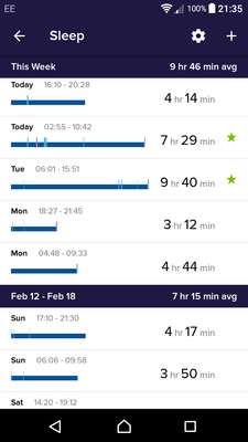

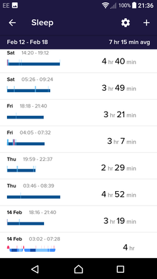

Mine seems to have lost the ability to track any sleep stages other than last night and the night before.
Been like this for nearly a month.
It gets worse the longer you leave it between sync's - the problem I suspect here is the Charge 2's memory and the way it stores details waiting till the next sync. The longer you leave it the more it forgets - maybe it is the EERPOM that is at fault. No idea but it is terrible for a product that is advertised as 'sleep tracking, tracks your sleep' etc when very clearly it isn't doing ir and not able to do it properly.
It is nothing to do with how it is worn in my case nor how I sleep, I am careful in these respects.
This needs a major update to sort out.
Only remember last night and previous nightOnly remember last night and previous night
