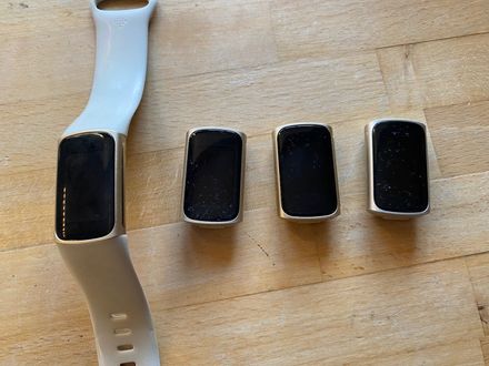

Final Update: Well it died a week or so after my previous post and have still not heard from Fitbit with any help whatsoever. No response to trouble tickets, emails or posts Seems they have their head in the sand hoping this problem will go away. I have been a loyal customer since the first band came out and this is how they treat me so I'm moving on. I have found many bands and watches that do as much if not more and in many ways are far more convenient. Do your selves a favor and leave this google megacorp behind.

@GaetanoVB It isn’t the battery manufacturing that is the problem. It is the design of the software. When their faulty app updates break the ability of the device to synch or communicate with the app, devices go into an endless battery draining loop trying and failing to complete various processes. They then can’t restart and get bricked because they need to communicate with the app to do so. This starts with app updates even before the firmware gets offered to you. And then installing the firmware on the device fails, also due to the broken synching/communication with the app. So most people can’t progress to getting the new firmware because it won’t complete the installation. And for those whose clock face goes black in the process of all of this, if they try to fix it by unpairing and re-pairing with the app, it dies completely due to the fatal flaw of requiring a code on the black device screen to pair properly, which is also a design flaw.

Interesting twist on this last night. My C5 started having problems - couldn't get the screen to activate. It occasionally flashed something briefly then blank. I checked the app and the dreaded 'an update is available' was showing. For over an hour I tried an unknown sequence of "Change clock" - lots of different ones and "Reset via the cradle button" Through all these the display either flashed briefly or blank. At all times the app was still able to communicate with the C5. When the display did breifly reappear I was able to set it to "always on" and "Max brightness" until it went blank again. During one brief recovery I was able to reset the C5 via the screen menu. Eventually it came back to life again - did futher clock changes and resets (menu and button) just to make sure and it is still working over 12 hours later. Don't know if my persistence actually kicked something back to life or just coincidence. The other thing, when the display was blank there was no activity from the green led on the back at all. Looking at it now, when the C5 is off my wrist the green LED is off. It only comes on when it is close to my wrist. I seem to remember some time back the LED was on all the while even when not wearing it and thinking 'that must run the battery down'. Either I am misremembering or this is a change. It is still on the old 188.58 firmware according to the App.
Update : Just in case the behaviour of some clock faces affects all of this - I am changing mine for now from 'Runliner' (the one I've always used) to 'Symphony' - a basic analog clock. Runliner must be a fairly intensive app - Time, date, HR and three stats displayed - could this clash with the update process???. More later ...........

I'm not sure why at this point any logical person would continue wasting time on Fitbit when they have amply demonstrated they are not interested in fixing their issue that bricked so many devices. My Charge 5 is still a boat anchor.
Nothing but crickets from Fitbit/Google. Cut your losses and move on to another of the numerous fitness band companies. Voting with your dollars and letting a company know why is all one can do as a consumer.

My C5 has now died again. Can't get it to respond to the button on the charger and battery critical so it also won't allow me to change the clockface. The support team have been very happy to replace it but this is the shortest gap between replacements yet. I don't think I'll get another one.

@JohnTheBrave not sure if you mentioning that your app never lost connectivity to your device was building on what I said about connectivity being broken, but I obviously wasn’t clear enough about what I meant. I didn’t mean that ALL connectivity gets broken entirely, just various critical processes, which it can’t get past and hence it drains the battery. And from reading this thread and others, the process that becomes the final straw seems to vary. One person deleted one of the health apps from their device (while attached to the charger) which stopped the battery drain problem for them. But my theory is that it depends what apps you actually use so it might vary as to what the culprit is…..which actually might fit with the dodgy clock face theory you are following, if some clock faces need to synch different data than others. I just use a simple clock face but it does display 5 data fields which you cycle through to see one at a time….zone minutes, heart rate, step count, distance and calories.
But i have only lost the onboard GPS and dynamic gps mode (straight after a minor app update) which drew me to the community forum posts on the charge 5. But when I saw what was happening to others with bricked devices I turned off app auto update on my iPhone (I now manually update all apps EXCEPT the Fitbit app) so I still have an app version from a few minor updates prior to the new app update fail, and I have not been offered the new firmware. Not sure whether I would have needed to update the Fitbit iOS app to be offered the new firmware in my region or whether they just eventually stopped offering it altogether. So I am still able to do everything I need to (I use phine app GPS to track walks) and still have several days battery life, but I’ve been following the forum updates in anticipation that my device will eventually get bricked like everyone else’s, maybe when I am required to update iOS to something that doesn’t support the old Fitbit app I’m still using.
