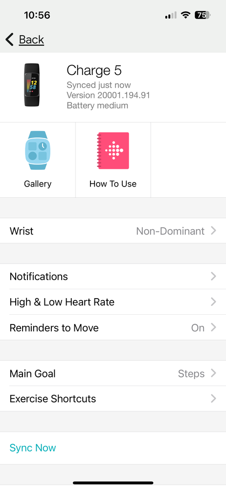

On Android App : 4.03 F/W 188.58 - I initially reported here in September 2023 that I had been offered this update multiple times and each time either the process of trying to download the upgrade in the background to my C5 drained the battery in a few hours before being able to put on charge or when it did try to upgrade the process started and after a few seconds it said the upgrade had completed but nothing had happened. Each time after charging or failing the C5 restarted and the App did not offer the upgrade any more. In November a F/W update 'appeared' to brick the C5 - no display but app connection still working - it took MANY, MANY!! repeated resets via the charge cable and clock face changes over about 1 hour to restore normal operation and again update not showing as available - worth trying this and not just giving up after a couple of goes!!! I changed my clock face after that to a more simple one in case this was somehow clashing with the update - from 'Runliner' (the one I've always used) to 'Symphony' - a basic analog clock. [Fortunately I never deleted the Bluetooth connection otherwise with the blank diplay I would never have been able to repair - game over.
About a week ago I finally got the 4.04 app update and yesterday I was offered an update (turned out to be 194.91) - I assume the previous goes were 194.61 but because they failed the version was never shown.
I nervously accepted the FW update with the C5 on charge and this time the display changed to a Fitbit logo and then various 'bars' showing progess. After many minutes - not sure how long - the display went blank - fearing the worst I touched the diplay and it had just timed out - the update was completed. The app now showing I was on 194.91 - not 194.61.
I do not know if any of the - App update to 4.04, clock face change, newer FW version 194.91 had any impact on this process but somehting caused the update to now work successfully and so far battery drain is 'normal'.

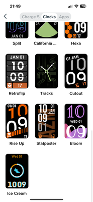

Have any of you who downloaded the updated firmware get any new watch faces? I did not get the new faces with the firmware download and there were supposed to be 5 new ones. Anyone?

I'm new to Fitbit. Just got my Charge 5 updated last week and saw these Clocks watch faces.
 Best Answer12-21-2023 07:27
12-21-2023 07:27
@hoangen these are all the old faces. There were supposed to be 5 additional new ones. Big fail on the part of Fitbit as usual...
