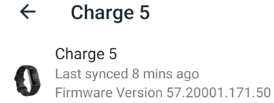

Can someone who got the firmware update please share the firmware version (its viewable in the app, when you select your device from the account page)
I'm currently on 57.20001.149.11, that is without any recent update that I am aware of

Here's what I just updated to:
@Wildcatguy thanks

That is the same version I have 20001.149.11 yet someone else seems t have a more recent one 20001.171.50. I have charged and synched my device but no change. Does Fitbit publish the latest version anywhere. I am beyond frustrated.
@Wildcatguy What version loaded for you?
My Charge 5 just this evening updated to:
57.20001.171.50
