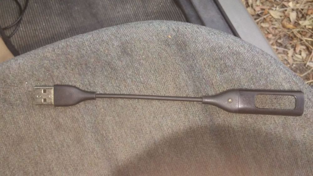

No, there is no tiny hole. And why do you have to put the fitbit into the charger? If there is a hole in the charger, it should be visible without doing that. Any way, I tried your suggestion, and there is no tiny hole anywhere.

Nice to see that you're digging into the Fitbit Forums @jsmanning and @Jokerjack, let me give you a warm Welcome to our Community.
Many thanks @Jokerjack for adding those pictures to your post.
@jsmanning, I just would like to add this: If your Fitbit device has one of the following problems, it may be fixed by a restart:
Restarting your device turns it off and on without deleting any activity data. If your device saves notifications, a restart deletes them.
How to restart a Flex:
Please note that you'll need a dongle in case you wish to synchronize with a computer without a built-in Bluetooth.
