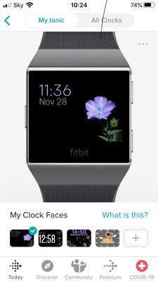

Mine started off very dark but I managed
holding the watch towards you
press the single button on the left this activate the front
flip down from the top if it shows % battery and date flip down again
you want it to show a music note a file and sliding bars
you need to tap on the sliding bars
this will show quick settings 4 in total two at the top two at the bottom
tap the sun one bottom left until the writing says normal
the others top right is do not disturb make sure that is off if the sun setting does not work
top right is the moon make sure this is off
bottom right is  the setting for two things activate the watch by button on the left or every time you move your arm I found the later annoying and uses more battery
i found my watch battery last seven days as my clock is a flower on the right with the time and date on the left And I am okay with that
