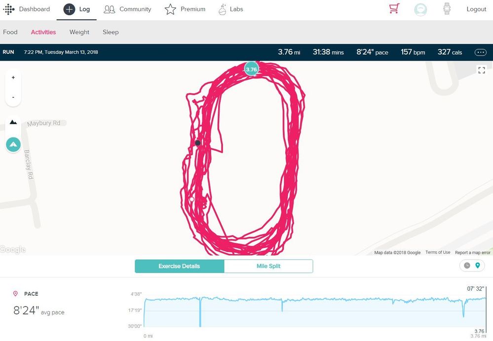

I have been using Fitbit Ionic tracking runs for past few months and my Ionic GPS results have never been accurate. I can understand 1% error but the results are routinely wrong by 10 to 20%. I am training for a marathon with a particular time target and this expensive watch completed frustrates the purpose of tracking the runs.
Contacting Fitbit support, I have been repeatedly giving reasons like potentially running closer to building, tunnels, poor weather etc. Just to avoid any such issues, I headed out to a running track last night. The skies were clear and the track is in the open so no reason for Ionic to be inaccurate. I ran in the same track just to avoid any errors.  Just to avoid speculation, the watch battery was full, the software for both the watch and fitbit app are upto date.
please see the attached screenshot of the tracking results, it is horribly wrong! can someone from Fitbit urgently look into this and tell me what's going on? Is this an issue specific to my watch or is the Ionic GPS faulty altogether (I have seen numerous complaints on the forum.)
Moderator edit: subject updated for clarity

The problem is that your Ionic is probably working as designed. The design is the problem.
