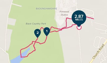

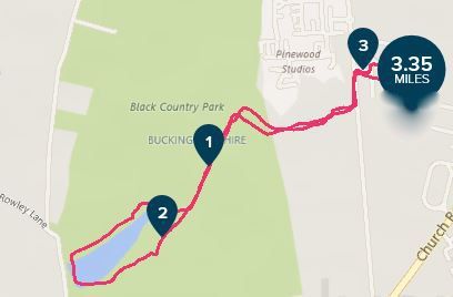

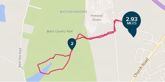

This is my old Charge 2 Run.
1 run with ionic
2nd run with Ionic
3rd run with Ionic
This is some photos of the runs. Sorry I've smudged the first part, its to hide my address for obivous reasons. Look at the difference in the runs vs the Charge 2.
I think I'll find the reciept and try get a replacement to see if that's any better.

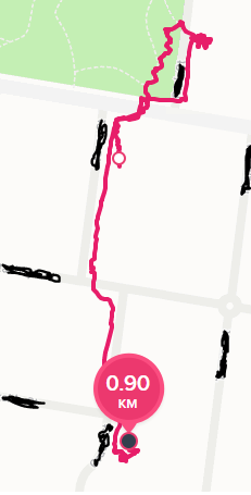

I tracked my walk to drop the kids off at school this morning, and it was pretty accurate - took a little while to get a satellite lock, but that's to be expected I think...
Street Names obscured 🙂

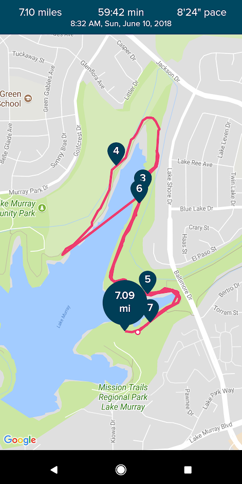

06-10-2018 11:28
06-10-2018 11:28
My first run after the update looks like this:
The weather is perfect. Totally clear without a cloud in the sky and my Ionic shows me running across the surface of a lake. Pretty bad.
