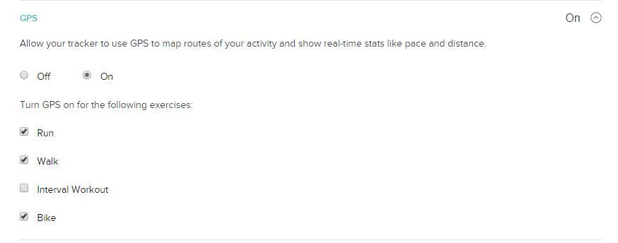

To add to what @bbarrera mentioned, also verify that your setting (via the website) are correct. They should be default to all "On" and checked, but who knows...

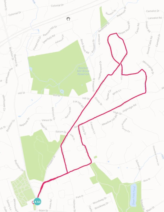

First, I have GPS 'on' and don't use auto-detect. I manually start the exercise after GPS is detected and the starting gun fires.
I examined the GPS coordinates so I know that it's working. They added up to 4.53 miles on a sanctioned 5-mile course. This percentage is consistently understated with the 8 other races I've participated in since strapping on the Ionic.
Here's the 'exercise' from the dashboard. There are a couple cut corners but I can't see how .47 miles could have been lost:5 mile race Nov 23 2-17.JPG
@bmw54, interesting; I don't think I've ever seen an accurate track on a map and yet had the total distance vary by more than a tenth of a mile over the course of a 10 mile run.  Regarding cut corners, my Surge was notorious for doing that and so too was my Garmin Forerunner (but to a lesser degree than the Surge); my Ionic plots corners and curves dead-on accurately roughly 29 times out of 30, and when it screws up, so far at least, it has always been on a heavily wooded trail run.
@bmw54 Wow, yeah, that is strange. Clearly ~0.5 mi short on what traces as a 5 mile route. Certainly is something wonky with your GPS.

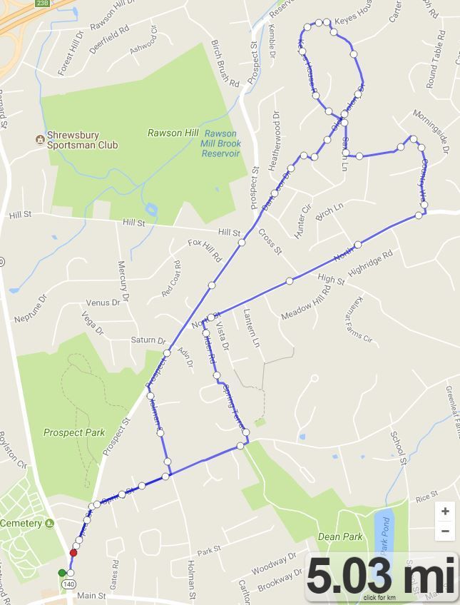

To persist on this subject, after a 10.4 training run yesterday that Iconic's GPS route tracked accurately and measured distance/pace correctly I'm left wondering what it is about racing that challenges Fitbit so badly.
Here's the race course and total miles (4.53 miles) as measured by the Iconic (last Thursday):
And here's the same course as measured on the web (5.03 miles... I may have overshot the finish line a bit):
sorry, here are the maps:
Iconic:

web:
I've been wondering the same exact thing about your Ionic.  Maybe mine always works, regardless of whether I'm racing or not, because I'm old and slow.  🙂
@bmw54 It seems pretty clear to me, you have a training pace and a running pace. For some unknown reason (existence of bug acknowledged by Fitbit in this thread), Fitbit is using your training stride to estimate distance and that means your racing results are wrong.
@bbarrera wrote:
Hmmm, that doesn't make any sense; I train in the nine to ten minute per mile range but typically race in the mid to high seven minute per mile range.  My Ionic and Surge both track flawlessly.
