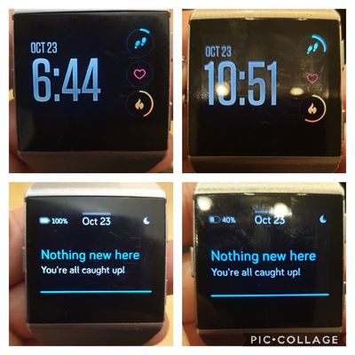

I had my Fitbit ionic for more than 2 years now and I could go several days without charging, even after doing 2 or 3 hours lesmills classes each day and I don't use the GPS and suddenly yesterday I started losing battery life at a rate of 25% to 50% per hour. For example last night, before bed, I charged it to 100% and I woke up in the middle of the night the watch was dead while not doing anything other than sleeping.
Things I've done to troubleshoot.
-Restarted multiple times.
-Factory reset
-Restarted Phone.
I've read several threads about this issue and have not come across a solution, not have I seen anyone who is suffering battery drain at the rate I'm experiencing it.
Any solutions? Something I missed?
please help

I have the same issue and am 100% sure this issue is related to the latest firmware. I was getting 4 to 5 days in between charges on my 2 year old ionic right up until I installed the latest firmware. Instantly battery life has gone down to less than 2 days.
I tried everything as most people in this chat have as well and it made no difference. I contacted fitbit customer support who refused to confirm or deny the issue was related to the latest firmware but like I said, I noticed straight away after the firmware install the battery drained significantly faster.
I can prove it as well. I have kept all the notification e-mails saying the battery on my ionic was low. This shows the dramatic drop in battery life immediately after the firmware install.
