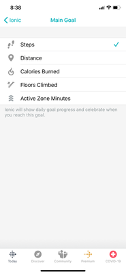

Hi, I've had some trouble with my Ionic. Recently, I changed my daily goal from 30 active minutes to 10,000 steps. However, the watch alerts me and celebrates for both goals (30 min and 10,000 steps). Also, the active minutes goal shouldn't even exist anymore since it was recently replaced by zone minutes. I've tried restarting and re-syncing my device, but nothing's worked so far.

Best Answer@SilviaFitbit Hi, thanks for responding. I did follow that procedure to change the main goal, and steps is the selected main goal. I also tried syncing the watch again, but it hasn't worked. I don't have a picture of the celebration animation, but I know it is the standard fireworks one. I've attached a picture of the main goal settings in the app.

@J.B.1. Thank you for getting back. I appreciate the screenshot attached.
If your Ionic hasn't synced, this could be the reason why the main goal hasn't updated, please follow this syncing troubleshooting. If it synced but the main goal doesn't update then restart your watch, sync again and let me know the result.

Best AnswerI've tried syncing my watch and restarting and syncing, but it's still alerting me for 30 min. of exercise. If there's not anything else I can do, that's fine, since this is not a huge problem.
