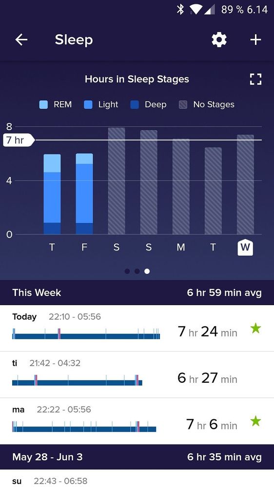

This happened to me!
This is an example that works perfectly on June 3rd : https://imgur.com/N4xNqDX
This is an example that didn't work last night on June 5th : https://imgur.com/HeAbL19
Why I have no stage tracking from last night?
Thank you!

I haven't got detailed sleep statistics for the past five nights! Nothing has changed the way I wear Ionic.
As the sleep statistics are analyzed on Fitbit servers I believe this is an issue on the serverside. Maybe something to do with the new firmware update? Fitbit just don't want to admit this. Fitbit support is useless just giving the same troubleshooting tips to try to fix this like restart Ionic, wear it tighter and higher up in the wrist, etc.
I am getting really tired with the Ionic constantly failing on some feature. Just waiting for a new suitable watch from Garmin/Suunto/Polar and I am out of Fitbit world for good!
