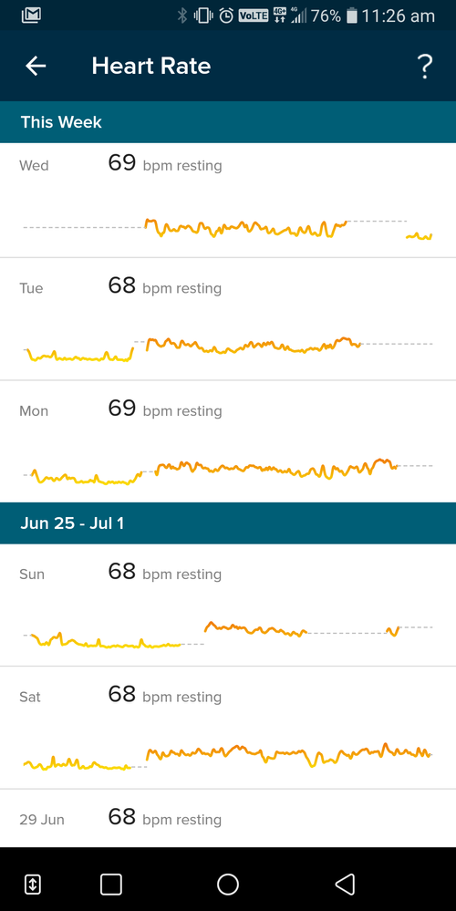

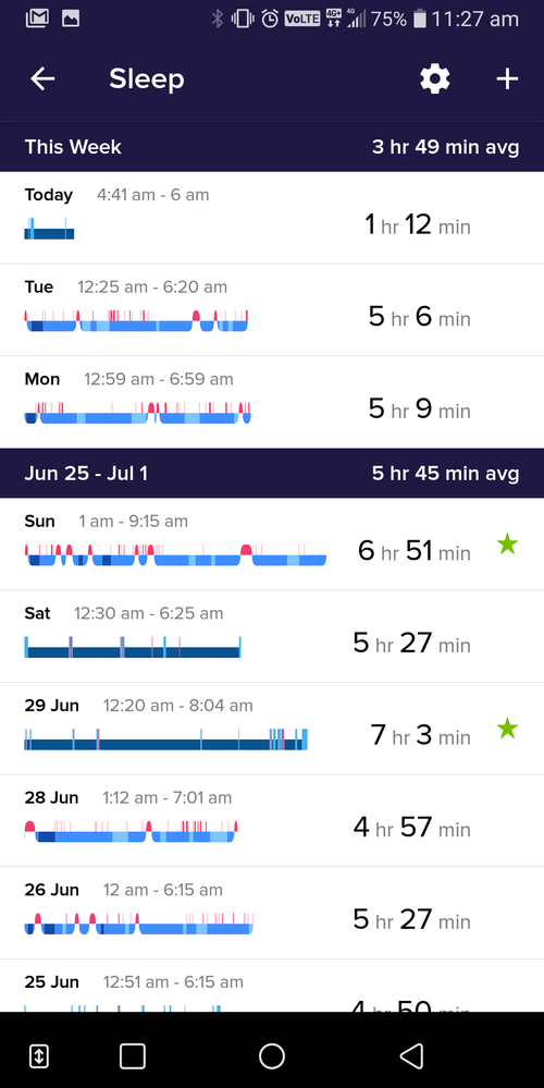

I notice I'm not getting heart rate reading at night. Battery life still above 60%. I'm wearing tight enough for HR reading before I sleep. Have follow your steps but my Fitbit still don't work.

Heart rate not capture at night but it used to capture it at nightHeart rate not capture at night but it used to capture it at night
I have manually set for sun, mon & Tue. But problem still exist.I have manually set for sun, mon & Tue. But problem still exist.
