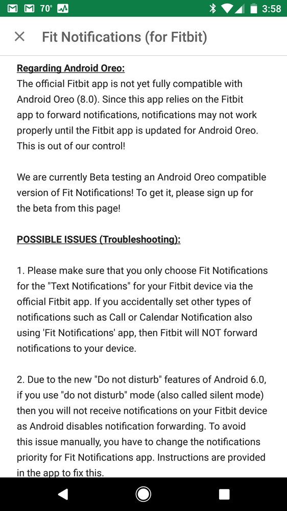

I have a Google pixel, running Android Oreo. I was having a lot of trouble with notifications, despite restarting both devices and resetting things multiple times. I was Googling things and came across this app that pointed out if you're using Android Oreo you need to disable all notifications in the Fitbit app except for text notifications. Once I did that I started receiving text notifications. To get the other ones going I opened up the apps and enabled all the other ones I wanted. Most things seem to be working just fine. I also have the notifications widget enabled. Hope that helps others with similar struggles.I have a Google pixel, running Android Oreo. I was having a lot of trouble with notifications, despite restarting both devices and resetting things multiple times. I was Googling things and came across this app that pointed out if you're using Android Oreo you need to disable all notifications in the Fitbit app except for text notifications. Once I did that I started receiving text notifications. To get the other ones going I opened up the apps and enabled all the other ones I wanted. Most things seem to be working just fine. I also have the notifications widget enabled. Hope that helps others with similar struggles.
Good call.
It says instructions are provided in the app to fix fitbit's notification priority but I can't find that anywhere!
