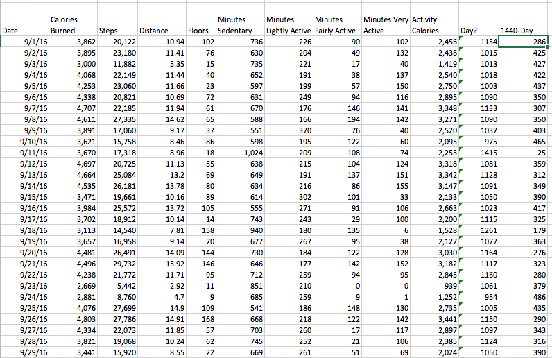

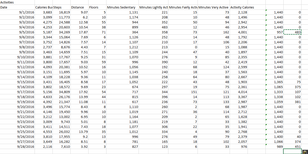

Hello @Baltoscott. I think I may understand some of my issue. But everytime I get close I find something that moves me back into there may be a problem.
I download the following report from fitbit.
There are 4 columns that should add up my day Minutes Sedentary, Lightly Active, Fairly Active and Very Active. I added 2 more - The total of these 4 columns, which should equal 1440 (1440 minutes in a day. And the last column is 1440-total minutes.
Total minutes should be equal to 1440, my last column should be 0.
I do not believe I am missing that many active minutes for the month, but I am definitly missing time, and some of it is problably active minutes that I believe I am missing. When I run the same report for August I have 1440 minutes for every day accounted for.
09-28-2016 15:55
09-28-2016 15:55
@SunsetRunner -- wondering if any of the days that don't add up to 1440 were days you manually entered activities. Manual activities can overwrite activity minutes in you daily activity reports and may mask the various categories of tracker recorded activity minutes that show up in this report.

Best Answer09-30-2016 06:14
09-30-2016 06:14
@Baltoscott thanks for the response. I actually do not manually add activity. I did try it back in May/June and it did screw everything up. I only use the automatic and timer events.
Best Answer09-30-2016 07:46 - edited 09-30-2016 08:00
@SunsetRunner - Looks like I'm missing more than you! None of mine add up to 1440.
Based on your results I was guessing the fitbit made a determination about lightly, fairly, and very active minutes, and dumped the rest of the day into the sedentary bucket. But that doesn't seem to be the case looking at my results. I think for all these days I was wearing my Charge 2, but August is similar (just 2 days added up to 1440) when I was mostly wearing my HR.
I may have issues because of imported activates, however. I bike commute five or six days/week and track that activity on a Garmin bike computer which gets imported to fitbit via Strava and MyFitnessPal (side issue: that creates double entries for the same activity, but they seem to serially overwrite tracker recorded stats).

Best Answer10-14-2016 10:04
10-14-2016 10:04
@Baltoscott I have found some more issues and I am beginning to think it may be my watch, but I can be certian.
I am not using any other 3rd party software, so all my data is coming from fitbit.
But last week my wife and I were on vactation. We were doing alot of hiking. She was creditted for 100% of the hike as active time, I only recieved about 25% of the time. Our steps and distance were almost exact.
I may drop looking at the activity time.
