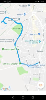

I think I'm having similar issues - I have a 2 year old charge 2 and GPS was spot on until the last ten days or so.
My last two runs have had the GPS either not work at all, or be way off. I've changed my phone recently but I don't think it's that given my partner has the same fitbit model and same phone as me and his is spot on, and the first run on my phone was spot on.

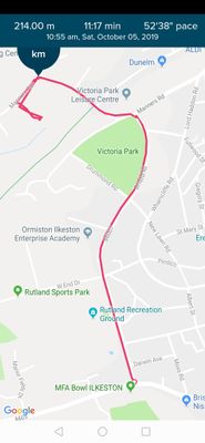

Just did a test in the car, starting a pretend run on my fitbit and starting tracking in strava at the same time. Strava tracked perfectly, fitbit device showed not connected to phone for half of it and didn't track half of it.
