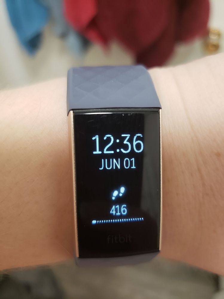

I have had a line across the top of my screen for weeks now. Tried mulitple resets. Bought this with the Boxing Day sale. It actually started after an update. Help?
I ended up returning mine. It was still within the 30 day period so I figured it wasn't worth the trouble...
How did you get the upgrade?
As you can see, the line is at the top of my screen . I don't even wear it in the shower so it hasn't gone swimming.  Multiple resets done with no change.As you can see, the line is at the top of my screen . I don't even wear it in the shower so it hasn't gone swimming. Multiple resets done with no change.
Not sure what you mean by upgrade.  I had a note in my app to update one day. Plugged it in and let it update. Took about 30 mins to finish.
