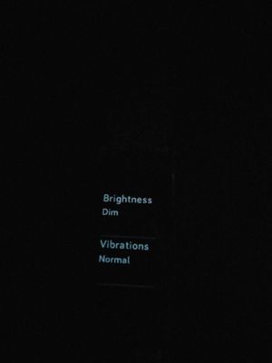

Hi, @kathamlin , it sounds like your Charge 4 may be on the Dim screen setting. I would suggest going into a very dark room. Hopefully when it is really dark you will be able to see well enough to change the setting. From the clock screen swipe left as far as you can go. On the final screen you should see the settings menu. Tap to open. The first item on the menu is brightness. Tap to toggle between “auto” “normal” and “dim”. Dim is almost invisible!

Dim is definitely an option on the Charge 4 brightness settings. The reason you didn’t see it is because Dim is almost invisible!
However, a fading screen is one of the things longer term users of the Charge 4 have sometimes reported. The Charge 4 was released in March 2020. That makes it pretty old in electronic device terms. I have had my Charge 4 since it first came out. I used it for a year or so and then leant it to a friend who used it for another couple of years before she returned it to me. Even though I suspect my friend did not look after it optimally (it’s important not to let the battery go into frequent deep discharge) in fact it is still functioning and useable, although I do agree that the screen is significantly dimmer than I think it used to be.
I suspect your Charge 4’s battery is also coming close to the end of its useable life and that is also why the screen is fading after 4 hours. As I am sure you are aware, all rechargeable batteries have a limited number of recharge cycles. The batteries in small, wrist worn, devices are also very small and the current technology means that they are likely to fail sooner than larger batteries with more capacity.
Of course I don’t know exactly how old your Charge 4 is, but it would have been discontinued as soon as the Charge 5 came out, so I expect it did pretty good service.
Below is a pic with my 3.5 year old Charge 4 on Normal brightness setting and another on Dim. I had to take the Dim picture in a totally dark room so you can see nothing but the screen - the picture is much, much brighter than what I could actually see myself…

Pictures!
And now Dim
