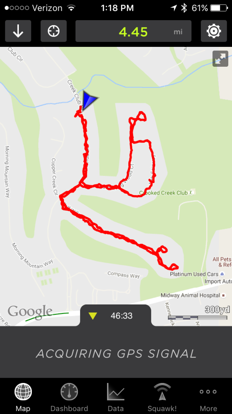

I seem to have this issue in spades.  The Charge 2 / Fitbit app on IOS recorded 1.33 miles in 46 minutes.  A GPS app from the same phone and same walk showed 4.45 miles in the same 46 minutes.
Fitbit App:
GPS App:
@rwynne i see on the first map that there is a out in the younder point, why 8 dont know, but this could be the cause of the error.

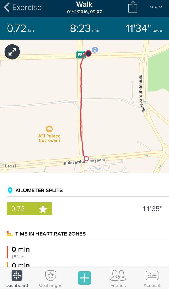

MapMyWalk -> 0,71km, 947 steps, duration 8:17
Fitbit -> 0,72km, 788 steps, duration: 8:23
So..I walked more with Fitbit and shows me 170 steps less. I think the latest firmware update has reduced too much the number of steps 😞

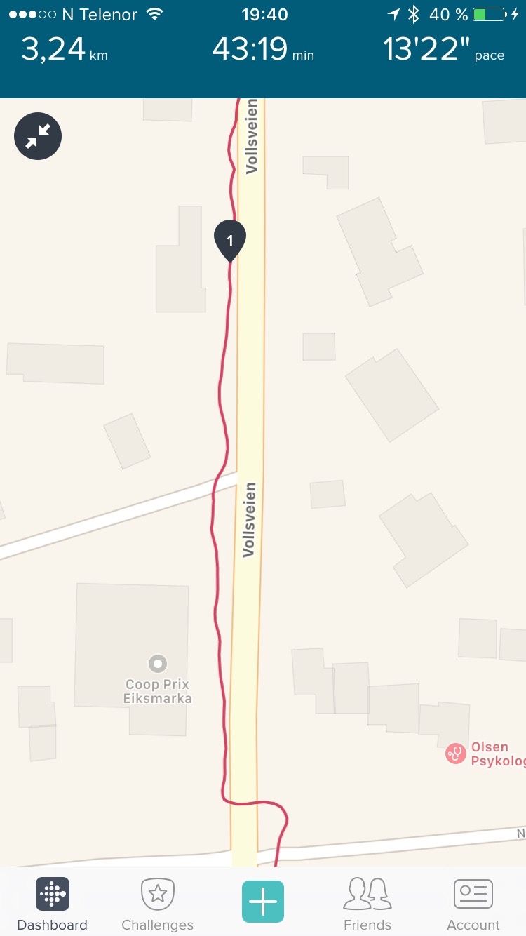

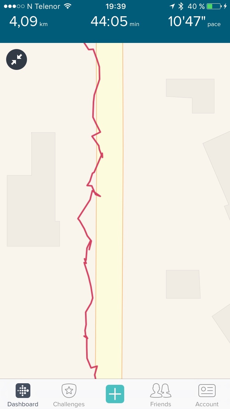

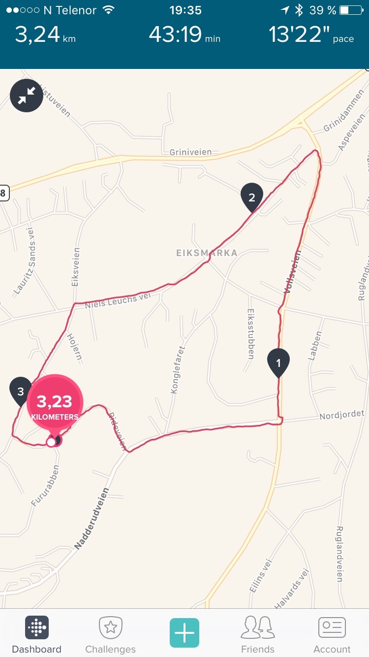

Took another test today.  Used RUN mode.
Walked on the side way of the street.
Map drawing equals looks ok for both.
Charge HR connected to iphone 7 : Distance 3,24 km
Charge 2 connected to iphone 6+: Distance 4,09 km
Drove the same distance with my car:  Trip counter 3,2 km
See attached drawings of HR and Charge 2

So the Charge HR smoth the line ( better direction versus my walking on the side ways ) while the Charge 2 har no smothing ( zick zack pattern ) so the direction varies on small icrements and distance adds up to be significant longer.  FITBIT has a job to do with the Charge 2 software while the Charge HR fit 100% my car trip counter.

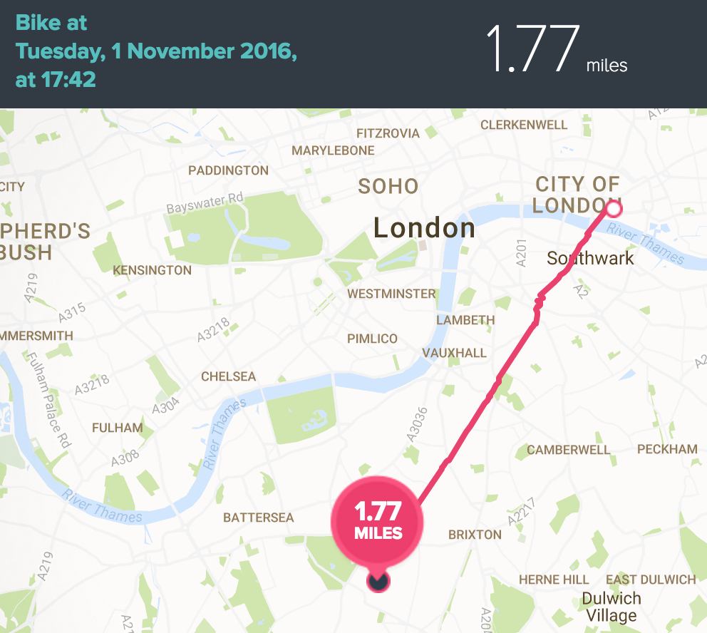

1st NOVEMBER = 1.77 MILES

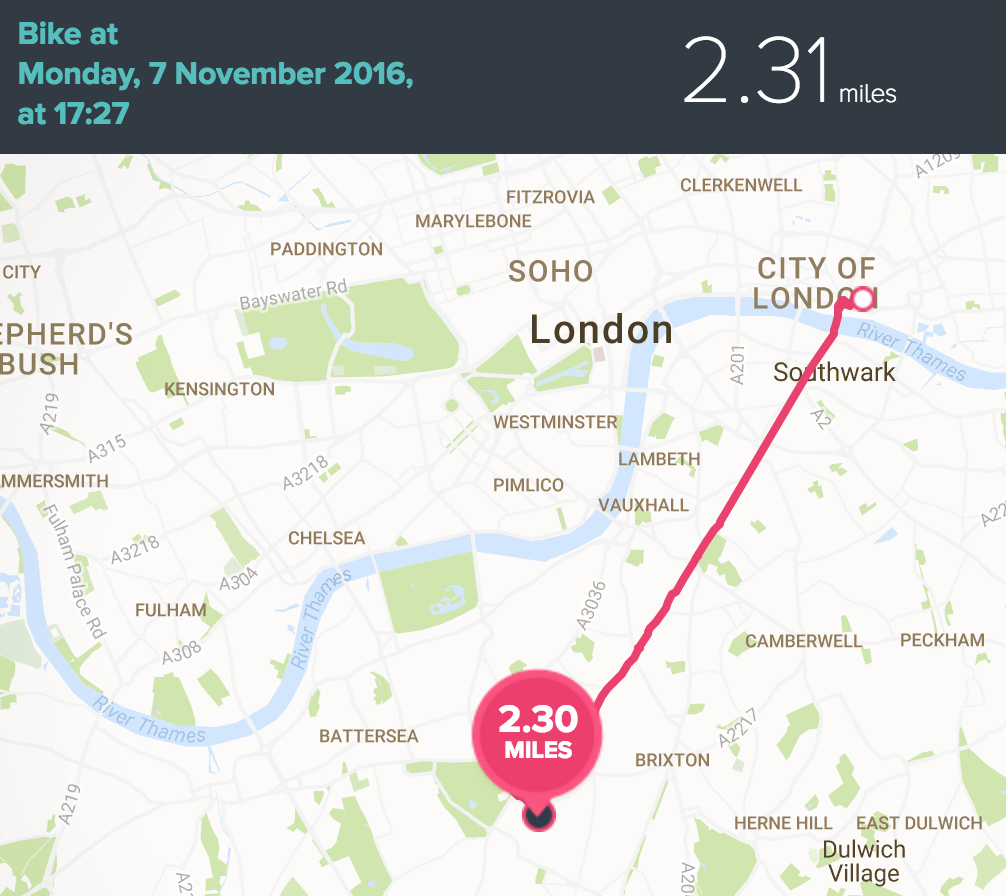

7th NOVEMBER = 2.31 MILES
